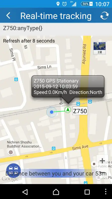

Install a GPS tracker on my bike yesterday. This can be bought cheaply from online website. Will need a GSM SIM card to work. Connection is only 3 wires.
Red to battery positive terminal
Black to battery negative terminal
White connect to relay link to fuel pump to cut fuel if bike was stolen.
