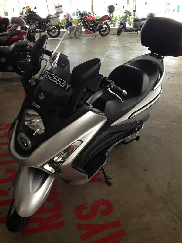

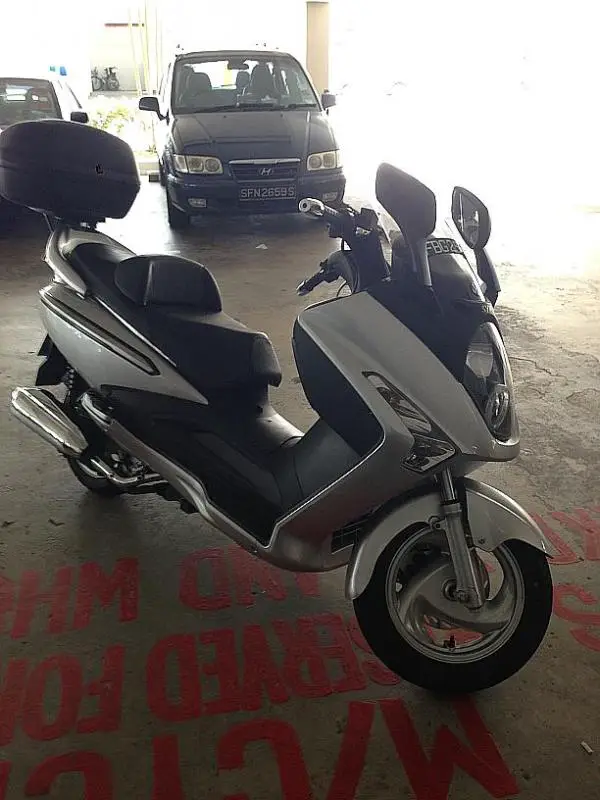

Selling my 2 years old SYM GTS 200.
Reg 15 May 2012.
Silver Colour. With good as new GIVI box.
WELL TAKEN CARE OF BY OWNER.
OBO.
ONLY Serious & interested buyers pls call me @ 9068 5976
