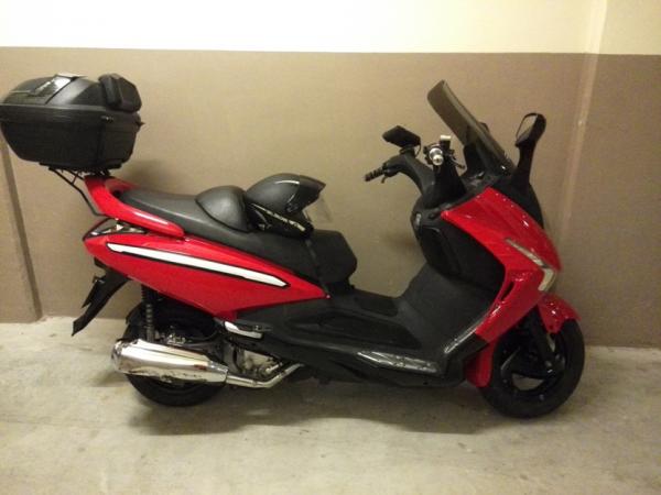

If anyone looking for a GTS200, I have one to let go. milage 101k, COE till 24 Oct 2015. with top box
im the 2nd owner, has been using it for commuting to work since 2006. Engine in perfect working condition, replaced several electrical parts (both charging rectifier and signal relay) 1 months ago.
physical outlook not that great due to parking at open space, seat stitches come out at some place and exhaust heat shield plate missing, havent fixed yet. other than that its working very well. selling because I have another bike and not really keen on extending CEO for this one.
drop me a PM if you are interested.

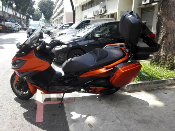

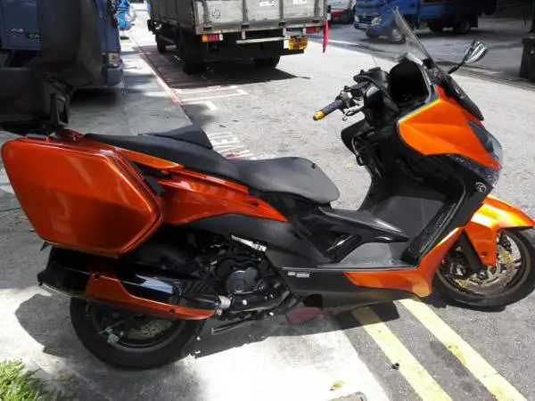

Hi,
I recently spotted this bike kymo xciting 400.
Very nice. Where can I get such a side box?
