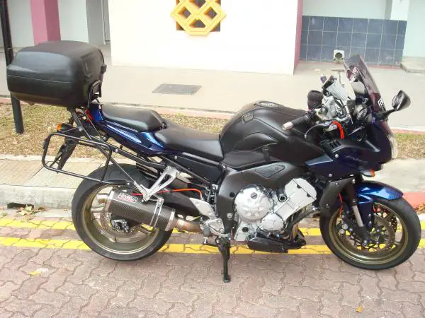

Hi, guys i am selling off my 08' FZ1S. If u got any friend looking for one pls direct them to my post in used bike section .
http://www.singaporebikes.com/forums/showthread.php?t=251401
And also currently not letting go of my accessories at the moment.
U can contact me @ 96900108
