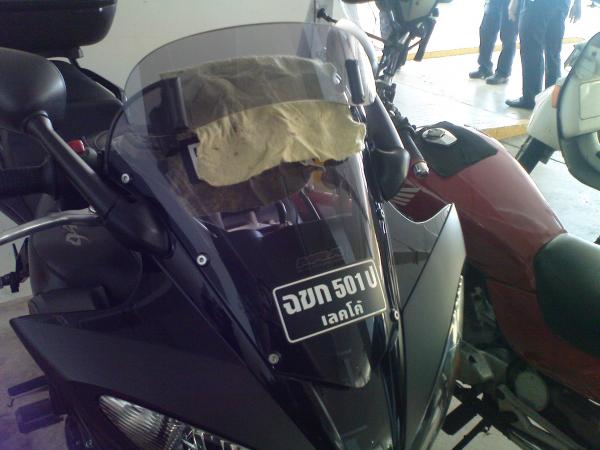

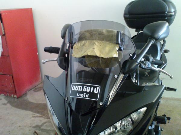

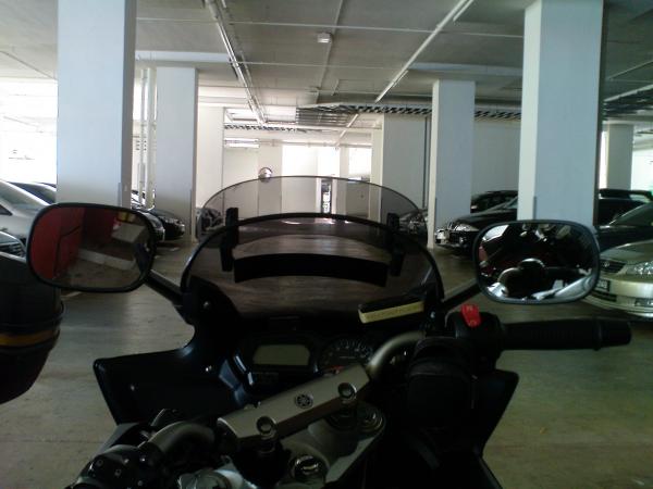

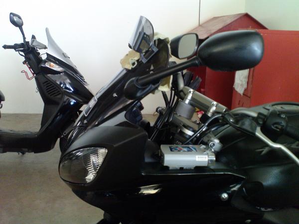

Guys, I'm selling off my MRA vario touring windshield for FZ6 S2 and here are the details:
(Important note: This item is not for fussy people)
  • Bought from Motoworld in March 2009 @SGD180
  • Right side of the top movable part a little loose, caused by bike drop
  • Right side of the top piece has a deep scratch, caused by bike drop
  • Even though right side is a bit loose as mentioned above, I'm still able to ride it at 200km/h during my last trip on NSHW, so still steady going!
  • Reason for selling: fell in love with another windshield! :p
Selling at SGD60, I've attached some pictures below, interested parties can PM me, thanks!
