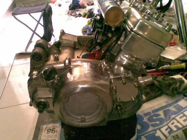

I am ready to rebuild my 350YPVS 31k engine, but need some one who can blast and clean the crankcases. Not bothered about mirror finish, but clean enough to paint.
Also, I could do with a cylinder head as mine has scratches on the ypvs.
Same for my 350 tong, but possibly going to need crank brearing doing.Where can I get that done for a decent price? Or is there a good shop I can hand the engine to who can do a strip and rebuild, cleaning and painting and renewing bearings (possibly rebore too)
Will do the YPVS engine myself, but don't have time to do the tong one...
good day bro, why don't you clean the casings yrself? get a can of paint remover, a copper wire brush with long bristles and a pair of rubber gloves. it's cheaper than sending to the shops. i've done a few casings myself that way. as for the YPVS on the cylinder, u can sand off the scratches using semi fine sandpaper and polish off with autosol and fine steel wool(buy from mamak shop). for the tong, u can send it down to AH KOK at kranji loop(62691692). he still does 350s and other 2strokes. it'll be easier if u can pass him all the new parts to save on time.:thumb:
