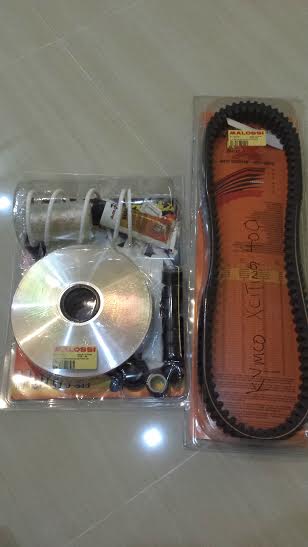

Jan two different people said different things, one workshop informed me 46mm, and another person said 41mm and now you say 45mm. I better visually verify this.
Yes several guys here installed Malossi clutch spring sets. It seems to work well but I myself using tech pulley KISS CLUTCH together with tech pulley Torque spring.

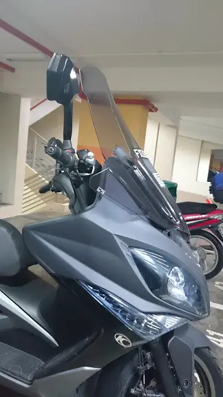

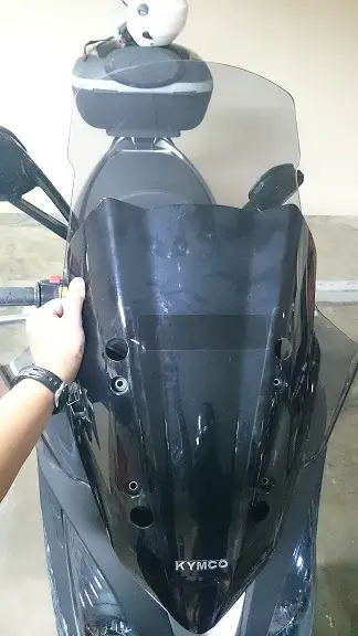

Anyone got feedback on their high windscreens ? Looking at a Puig one now
MD
http://www.singaporebikes.com/forums/attachment.php?attachmentid=177769&d=1286428855
The 1 they just posted on their Facebook page? I m quite happy with the default 1 cos is black, goes well with my matt black
Looking for brake levers, anyone got recommendations where to get? Saw someone selling CNC brand on Facebook but not sure good or not. Someone else recommended racing boy brand but not sure if LAB is selling or not
mine's matt black too, but i prefer a bit more wind coverage

Just a little higher rpm before take of.
The Malossi I have, got 10 gram rollers and I still have to test that +20% spring instead of the Malossi +13% spring that I use now.
With use of lighter rollers it make more sense to use harder spring.
Cheers Jan
With use of HEAVIER and no way lighter rollers it make more sense to use harder spring!!!

UserGR, does the Polini variator reach the 8000rpm. ?
@ Ramzi
I think the big nut onto clutch is 45mm.
Do you already have the Malossi set?
I can tell you that it really is da bom :bouncefire:
Cheers Jan
YES it does reach 8000rpm
