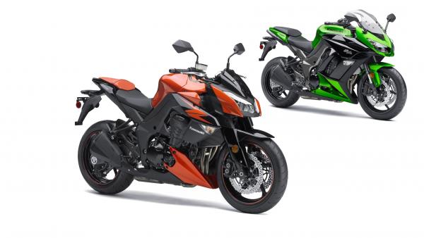

Hi guys, I'm currently deciding between getting a new z1000 or z1000s but still can't makeup my mind between the 2, both are so fabulous, any advice?
Did abit of research on the kawa bikes, called up Everygreen, was told to contact Excel cycles and M1 Motoring, (their distributor) which quoted me 29k for SX otr, but have to wait end of may for stocks.
Are there any other shops I should get the bikes from besides these 2? Any comments on loois motor?
My initial dream bike was cbr1000rr, but after I saw the kawasaki naked bikes, immediately fell in love with it :DDD
Too bad SX only comes with green & black, personally I prefer the color scheme of the 2010 Z1000, but can't find it anywhere now.
Very much hope to join you guyz in meetup soon.. :)

its all about preference. loois is fine, cant go wrong with a kawa. built like a tank.
Last I heard Loois selling Z1000 26-27k depending on age. SX prob 31k.
Ridiculous price for a Jap bike.
