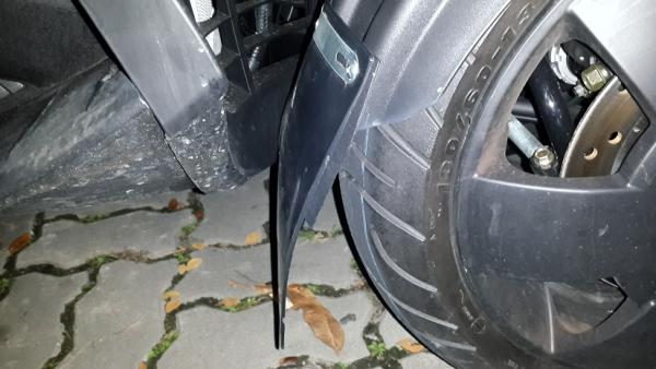

Yes the mudflaps work. First they have virtually eliminated any tyre spray from reaching the wheel well. Secondly the angle of water jet leaving the front tyres are significantly reduced. This means the water does not spray high enough to pass through the narrowest part of the gap but still manage to hit the board below it, which is perfectly acceptable to me at least.
One slight concern may be the mudflaps contacting the tyre very slightly on hard deceleration as I notice some very light scruff on the underside of the flaps. As they were really slight I decided to leave it as it is and further observe.

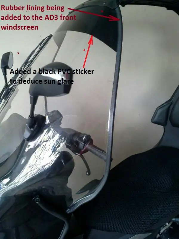

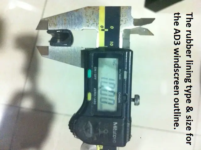

1) Photo 1 shown the AD3 has a PVC sticker being stick on the windscreen to reduce the sun glare. The rubber lining was added to the windscreen edges for water repel and safeguard the polycarbonate windscreen edges.

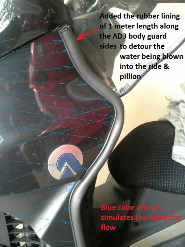

2) Photo 2 shown the AD3 front lower body guard has a thicker type of rubber moulding lining added to the edges. This is where the main concern is as where the rainwater seems to be flicking their entry into the rider and pillion cabin area.

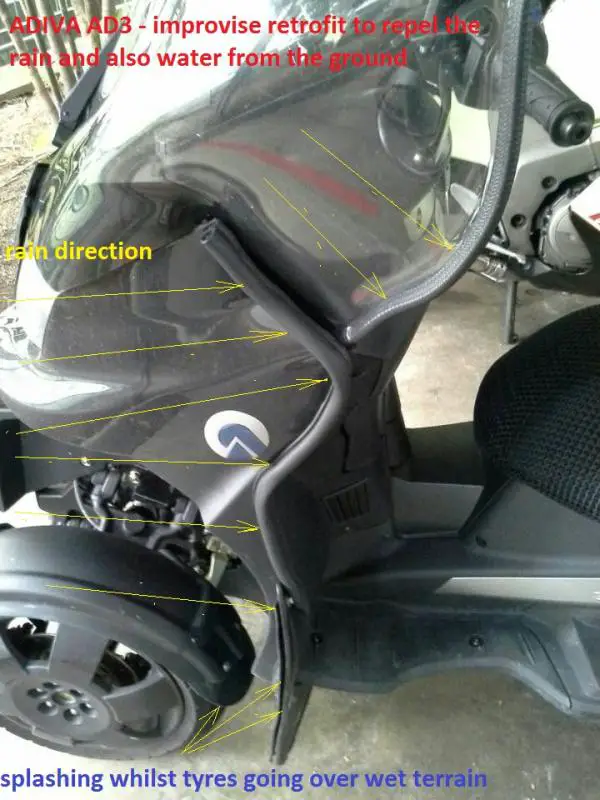

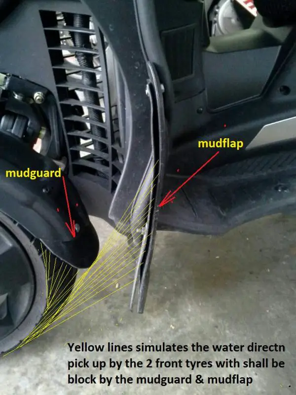

3) Photo 3 shown the simulation of the rainwater direction...
4) Photo 4 shown the simulation of the water pick up by the AD3 2 front tyres which can be minimise by adding the mud flap and mud guard.
5) Photo 5 shown the mud flap.....Besides the online order for the mud flaps, we can buy the rubber pieces locally as they are low in cost to be cut and trimmed ....

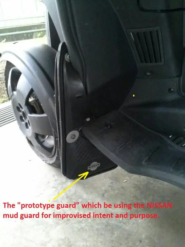

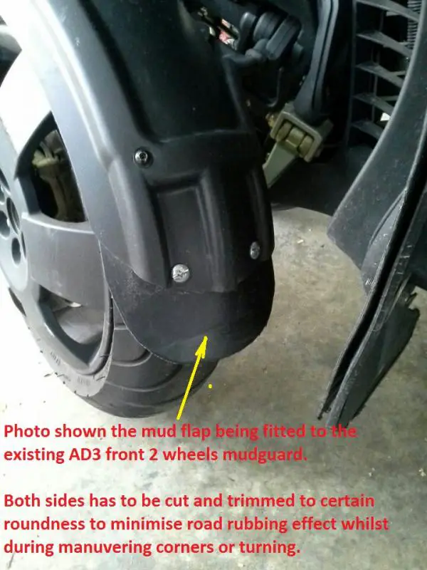

6) Photo 6 shown the mud guard added just after the mud flap. The mudguard was taken from Nissan car's rear ......

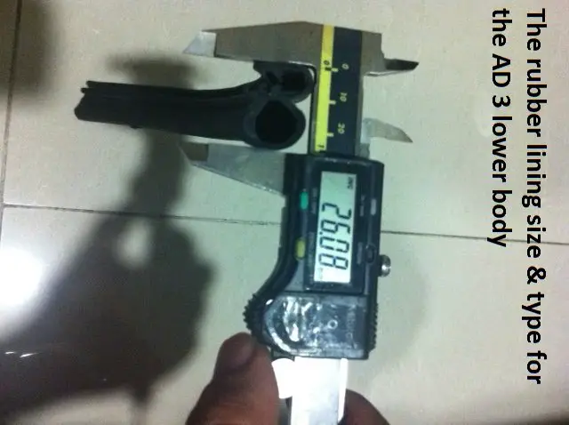

The last 2 photos shown are the 2 types of rubber lining. FYI the first photo shown the 10mm rubber lining which was used on the windscreen edges, both for repel the water and added protection to the polycarbonate windscreen. It requires about 2 meters in length and is retail for about $4 per meter run.
For the AD3 front lower body edge which the 26mm circular cushion rubber lining was used and requires about 2 meters length. It was brought at $6 per meter run.

Please also note the rear tyre also has to be fitted a "large size" mud flap. This was highlighted earlier in Ben1112 recommendations where the rear tyre will kicks up and swirl the water into the cabin's rear.........

Dear adiva89, the mudflap looks like it would work really well but in my honest opinion it is a little ugly at the moment. The mud flap itself looks fine but it's just the hardware and probably the way it's mounted makes it look like a 'hack' job. I would suggest that the logo be painted over and a smaller washer be used. Also the open end nuts could be changed for closed 'dome' type nuts and have the mudflap edges cut to line up the body better.
As this is a prototype, I hope that you do find my suggestions constructive and not too overly nitpicking as I think your design has the potential to be the perfect solution while mine is just a simple one.
I have struggled with myself for awhile between pre-fab and DIY materials but settled with the more expensive option for aesthetics and ease of application. My pov is that even in its original state this bike is very good looking and I try to not alter it too overtly.
However the application of the rubber D pipe is brilliant which I'll definitely adopt but will only run it up to the point where it meets the windshield edge as it should look nicer that way and the excess may be limited in function as well.

:thumb: Lan, mind sharing some pics? Also did you add any support on the underside as I did? If you didn't it may contact the tyre.
I actually used the plastic cover of a black plastic file (like the ones with clear pockets for holding documents) and cut out a shpe to support the mudflap as the mudflap was too soft. Pic attached below.
Not sure if the mudflap is the cause, but seems to feel that the front wheels are not as stable (very slightly) when I ride above 95 kmh. Did not feel this before the mudflaps were installed, but think the impact is really quite small. Likely I am very sensitive to the feel of a bike...

I tend to agree that this prototype looks like a hack work...nonetheless once the rain deflector design concept is affirmative which the refinement process shall follows.....
Don't be alarm that this said modify work would have to "cut" or "saw" the AD3 body parts.
FYI the car mud guards are fitted without drilling the AD3 lower body.
The lower part of the car mud guard is screw on using the existing AD3 body screw holes and the top part is "clip on" and they are held down by the added on rubber lining......
