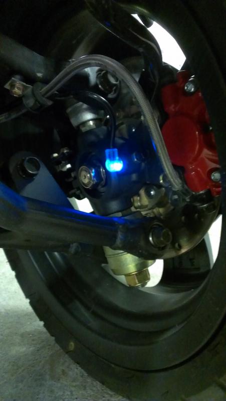

[ATTACH=CONFIG]288131[/ATTACH]
Look! My bike has blue undercarriage LED from factory! This one TP cannot catch one! :cheeky:
*(Anyone want to guess what is it?)
The only factory blue bulb I can think off is the hi-beam indicator light. It dropped out?o_O
Bo la bro, you check your bike when u just turn on also have one.
