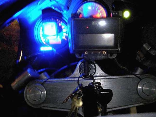

fitted my Cat Eye too some time back... here is my Night Viewing Solution
