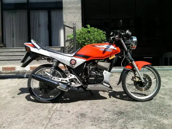

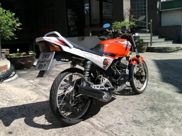

Hi :)
No, the sprockets are of the regular width same as stock RXZ sprockets. The smallest available is 28 if i'm not wrong.... but that requires some serious horsepower (or 16" wheels).
I did change Destiny (the bred bike) to 17" because i had aluminium rims in that size, the rims are 1.40x17 and yes, the tyres could be considered sotong...... 70/19-17 rear and 60/90-17 front. To match the speedometer (meter set from Catalyzer model) to the new size tyre i use a speedometer drive from a Yamaha Mate kup-type bike, this fits on the RXZ front hub and the gearing is correct for 17" wheels (Mate has 17") to make sure the speed is shown correctly.
A front fender from a Honda Sonic RS fits perfectly, without any modification, to RXZ's front fork and matches perfectly with the 17" wheel, too (as Sonic, too, has 17" wheels stock). The stock RXZ fender with the small wheel looks so weird...... The colour was a little darker red so when i had the tank re-done i ordered it in the same colour as that fender ("Honda-red") and now it is perfect (other parts are silver, to imitate Catalyzer look).
Please see attached photos for details on tyres, fender and the cone airfilter mated to the stock airbox.

Just LUVVVVVV the side racing-style-protruding cone filter!!!! But if tat were to be my bike, I'd keep everythin else but let go the weird rounded-shaped headlight. SQUARISH looks better on an all boxy coverset type RXZ...:angel:

Hi :)
But i love my chromed round headlights.... i have the same headlight on both my RXZ, this is taken from Kawasaki GTO Mk. VI. It gives a much better light than the stock RXZ one.... and, in my opinion, looks better too (if used without any front fairing, obviously if a fairing is there the stock one looks better).
Plus it matches better to the Catalyzer type meter set (again if used without fairing) because that is round-shaped as well. I will ultimately have a Catalyzer meter set on Bulldozer as well, i'll buy a brand-new original one once i hit 100,000 kilometers so the odometer is showing correct (easy to reset that meter on my stock set however impossible on Catalyzer's as i can't open the speedometer on those).
