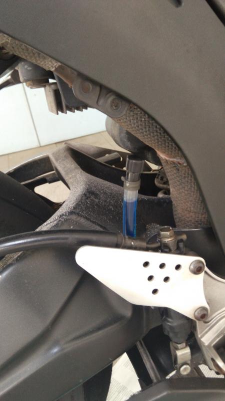

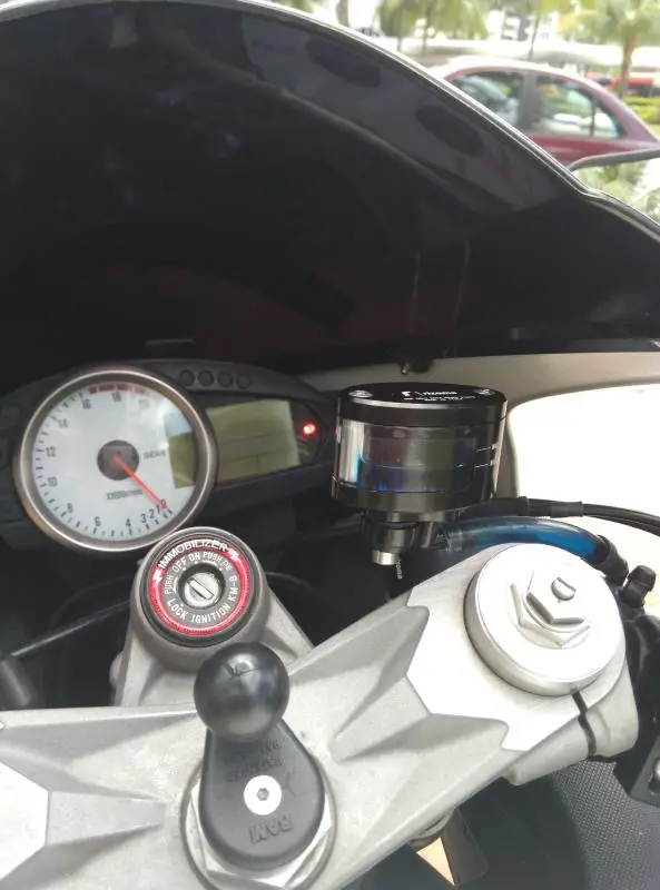

Done with my bleeding with ate brake fluid and tygon 2375 hose.
