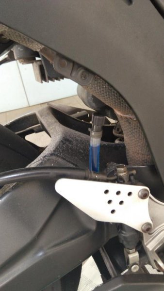

While I read the thread, although I find that there're quite a number of people who knows the job, but there's a faster and more efficient way of bleeding brakes. But it may cost a bit more.
Borrow an air compressor to do the job.
There's a special suction tool powered by an air compressor which can connect the ports to the nipple and conduct bleeding with a fraction of the effort and several times effective to ensure a clean fresh brake fluid.
http://i115.photobucket.com/albums/n298/arakyo/picresized_th_1201411472_DSC01065.jpg
When I replaced my brake hoses for my R1, I used this tool to speed up my job. Clean, little hassle, thorough, extremely fast, overall very much efficient. Perhaps people who're interested can opt to buy this tool. Very cheap (definately
For brake calipers with dual ports, you can always buy an auxiliary Y hose to conduct the bleeding. If not you can do it sequentially with a single hose too. Doesn't matter. Those bikes with complicated brake hose system like the Honda Blackbird CBS, don't bother doing with the manual method. You'll take ages to complete.
This tool simply don't bleed. It actually flushes your brake hose brake fluid.
http://i115.photobucket.com/albums/n298/arakyo/16012011003.jpg
