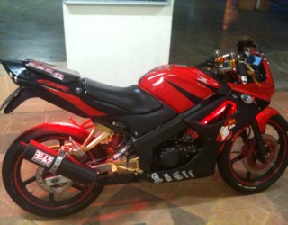

Heyy guys ive been working on my gf's cbr... Planning on changing to spookey rims.... Any advise or comments about changing to spookey rims???
were u the bro who posted abt yr gf's cbr150 kena stolen and after that recovered back? i tink the bike has undergone super transformation! :thumb:
i cant be sure whether is it possible to find wheel hub for the spoke rims that can fit our original brake disc perfectly. if cannot, then this mod is going to be costly.
got a feeling that the shop will recommend u:
- y125z wheel hub (front & rear)
- yr choice of spoke rims + spokes
- y125z brake discs
- modify relevant spacers to align spoke rims w/ caliper
if the y125z brake discs are different size from our stock discs, add in the price of getting new metal bracket to mount e brake calipers.
total amount spent for the mod may easily run to $300 & above.
:sweat:

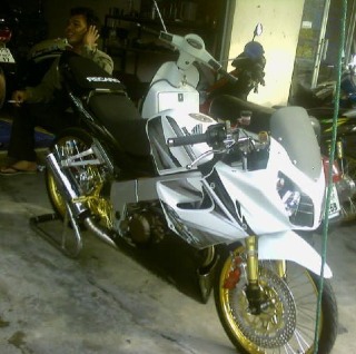

well if anione has got lobang for the pipe pls pm me....anyway guys i found this pic on the web...really cool steering damper on cbr 150...just wanted to share with u guys...its similar to steering dampers on class 2 bikes..
