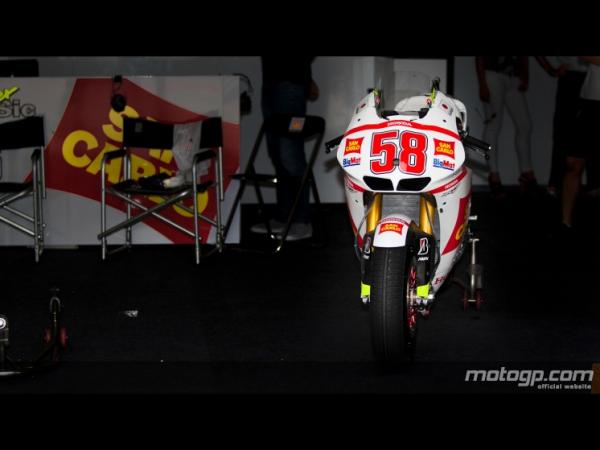

a sad day after retuning from sepang.. Got his autograph and shook his hand on sat, sunday he is gone. life is short
RiP Marco Simoncelli #58, you will be miss
