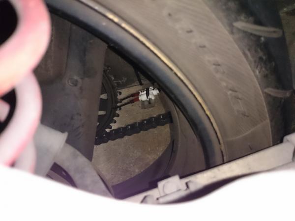

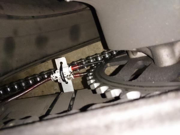

Hi Guys I got my scottoiler quite awhile back however I don't really like the way the oiler only supply oil to one side of the chain.
I saw that scottoiler had their own dual injector but the price is kinda not worth it in my opinion and somehow I feel they should have supplied this in the first place instead of selling it as an add-on.
So I did some research and measurements and made my own dual injector

Care to explain how is the item is to be installed on an existing scot oiler? Just replace the injectors?
Sent from my 2013023 using Tapatalk
swat[/MENTION]_;8212734]Care to explain how is the item is to be installed on an existing scot oiler? Just replace the injectors?
1. remove the current single injector head.
2. find a suitable location (preferably on the swingarm) to secure the stanless steel plate and splitter connector (both the item is part of the $15 you paid for including cable ties for securing).
3. measure the length required and cut the excess length of your oil tube.
4. plug the end into the splitter.
5. from the excess length of tubing that you just cut, cut another 2 short length as shown in the photo of my first post.
6. if you bought the scottoiler first hand you should have 3 injector head in the box. (the thin black tube at the end of your oil tube)
7. you need 2 of it and plug it into the 2 short length that you cut in step 5.
8. now plug the 2 injector head with tube into the splitter and do the final adjustment to let it rest nicely onto the sprocket and you are done!
