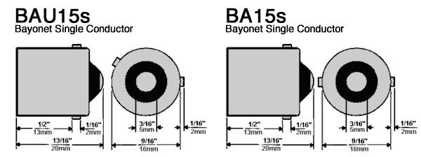

Sorry I have a noob question signal light is using wad light bulb?
As far as I know, Spec 1 and 2 original signal bulb is a 1156 BA15s type.
5W should be enough.
