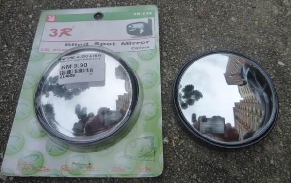

solved my blind spot issues, bought a pair of 75mm blindspot mirrors
what a great difference with and without
