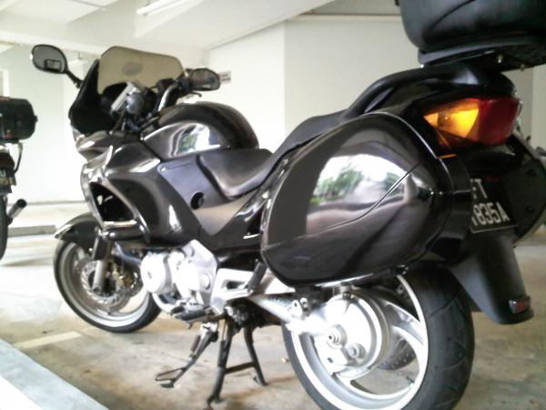

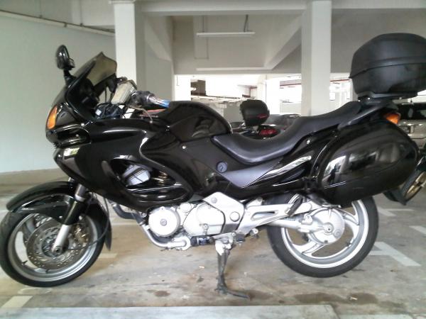

Managed to rectify the sounds by changing the cone bearing which i got from FJT.Bike handles better now.i am overall happy with how the bike is..in terms of smoothness and comfort.Here's the picture of my ride.
[ATTACH=CONFIG]193843[/ATTACH][ATTACH=CONFIG]193842[/ATTACH]
Bro Jan: BEAUTIFUL bike. hope you have many years with it.
