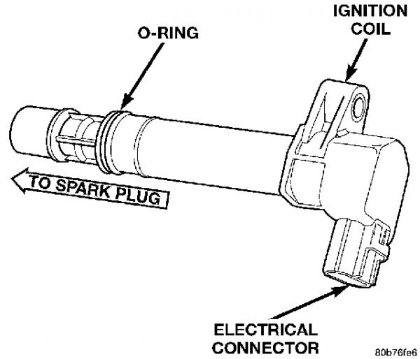

Will iridium works better with higher grade of plug cables? Coz have heard bad stories of people ruining their pistons due to iridium. I'll sure stick with Denso or NGK if going for Iridium as they are a trusted brand.
I'm not sure about cables part. I've heard of NGK racing spark cables but never gave it a thought.

The stories you heard are prolly of OWS and Hodaka brand plugs.
Quite a big issue that time. One S4 had to do overhaul but MW paid for it since its their product and installed by them.
Otherwise, original NGK and Denso iridiums should have no issues. I've used NGK iridiums from LAB on my TLR for years with no issues at all.
I read on the net that colder plugs gives you more top end but in the long run will suck petrol like water. Thus mostly used on track. How true is this?
As far as I know, the concept of hot / cold plugs are based older carb bikes where its quite difficult to tune aged bikes.
Older bikes tend to leak small amounts of EO after a while so it will tend to foul plugs easily. Since its hard to compensate by tuning carbs (its really impossible to tune carbs correctly at anything below 6500 RPM), usually hotter plugs are used to reduce the fouling.
Colder plugs are used if the setup is much more lean, which is probably the logical setup for most race bikes (lean to push for max BHP and fuel efficiency).
In this age of custom tuning and dynamic mappings, hot / cold plugs play a lesser role unless one is a strict non-modder (totally stock bike, no remaps, no aftermarket parts) and requires different plug ratings to match the engine setup. Also, bikes with some severe oil leakage issues in the piston area and do not wish to have it repaired for financial reasons can opt for a cheaper workaround with different plug ratings.
Currently the ignitions systems we are using are called Igniters which is pluged on to the sparks plugs, once the sparks plugs are screwed on top of the cyclinder head & the tempreture it can witstands ranges is around 160° F to 165° F - best esitimations & connect to the wire-harness...
No more cables + seperated ignition coils except old bikes + cars...
USD$11++ wheres my green packet...
Cheerio Mate...:cool:
the ignition costs about $100 each if not mistaken. I met a guy changing his for his Fazer 1000. if change 4 then it will be $400!!!
Not sure they are the same as ours??
