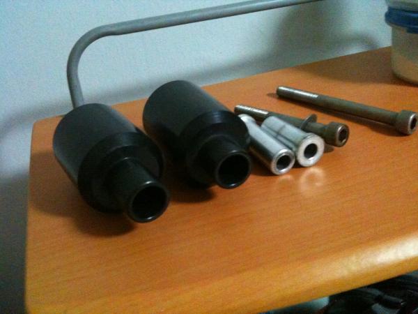

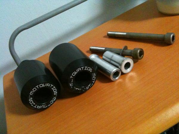

Hi Gsr Riders,
I have dug out my Mid Flame sliders from Motivation in my store room, selling at 35 dollars.
Sms me at 94787700 James.
Some Pictures to go along as requested.
Still upzz for sales..

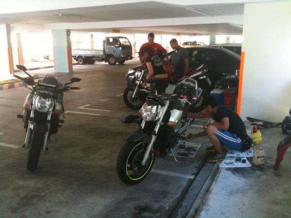

o_O-D.I.Y SESSION -o_O
Time: 1000 HRS - Onwards Own time Own Target Carry On...
Date: 25th 04 2010 Sunday Morning
Location: BLK 426A Muilti-Storey Car-Park Level 4B
Woodlands St 41 - Right Beside Singapore Amercian School
Purpose: Replace Engine Oil + Miscs Repairs
Just Drop By Chill With the Crew
** NEWBIES ARE WELCOME TO COME **
-You Got Questions??? We Got the Answers-
Remember Show & Tell Sloves Everything
Bring Cathalogs, User Guides or Manual Etc...
Tools & Beverages are Provided By Bones Mobile WorkStations :p
Parts & Accersories Sold Separtely Batteries Not Included...
