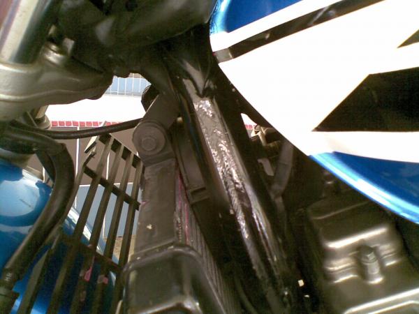

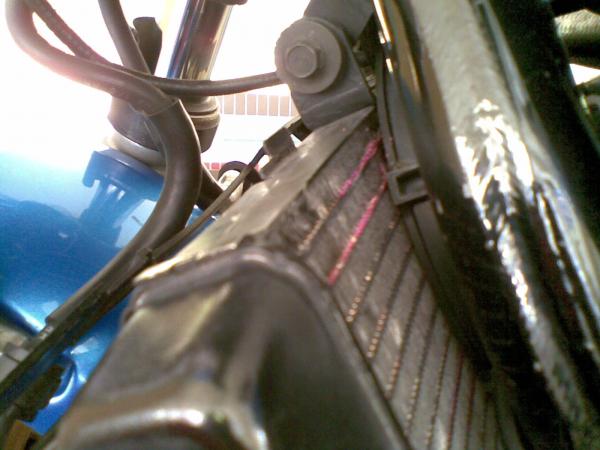

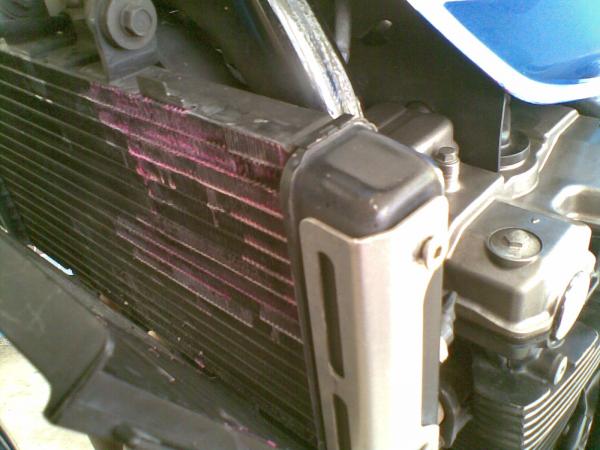

i hav this problem on my radiator.. My coolant keep leakin from my radiator sumtimes it sprays water at the fan.. Any idea what problem is it? Do i hav to change the whole radiator?

wait.. can anyone tell me how much to change this gasket? i JUST experienced same thing since yesterday. temp light on while on expressway (1st time in 2 years, i saw the light.) and NO fan sound..
so can i safely conclude it is the gasket? any other possibilities. need help before JAM!!! thx~
" How did the "KEEP OFF THE GRASS" sign get there?"
Thought you solved your problem by changing whatever gasket there is but I never personally heard of our S4 system having use gasket unless something I missed.
There are only three things that can caused your system coolant system to fail...1) Coolant pump 2) Radiator sensor fan switch 3) Thermostat jammed.
Temp red light coming "on" is the most serious of all. It mean you are running on very low overheating coolant or non at all. Sooner or later..your block material cannot take the heat and its gonna crack.
If the gasket you are referring to is the outer ring coolant seal for the water pump..I suggest you rather have the whole pump changed because the oil and coolant seal in the inner shaft may be bad already..so changing that seal is not gonna be of any help.
