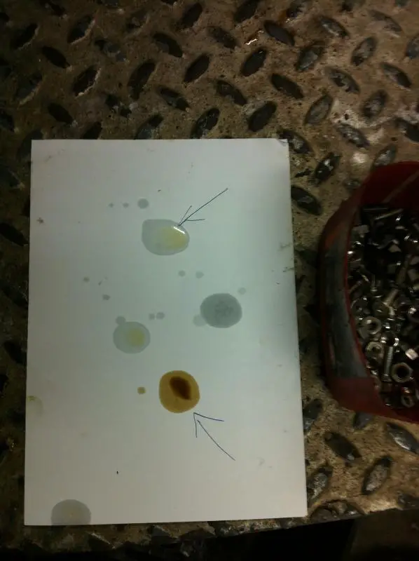

Don't use car engine oil for motorcycle cos will cause clutch-slip problem.
Always use motorcycle engine oil.
Not true. This theory has been officially debunked by yours truly recently.
I've been running Mobil 1 fully synthetic for cars since Jan 2012. Just changed the oil yesterday after about 7,000km. The oil is still good for at least another 3,000km but I decided to change because I'm going for 2 long trips this week: Leaving for KL tonight and Langkawi Charity Ride on June 7. If not for these long rides, I would have run the oil until at least 10,000km.
This is my first time running car oils on my bike, so I'm "experimenting" with the mileage. I will be increasing the mileage over a few oil changes to see how much I can stretch the usage. Next change will be at 10,000km.
I have a friend who rides a Busa and a Spec 3. After reading various write-ups debunking the myth, he was the one who finally convinced me that it's ok to use car oils. Both of his bikes run on Mobil 1 and his mileage for oil change is 25,000km! He has been doing this for his Spec 3 since day 1 when he bought the bike brand new. It's now logged about 200k+ km and has not developed any issues at all. No valve clearance and etc.
Of course, I'm a bit more conservative than he is so I'll go for early oil changes. I'll be happy with 10k-12k km oil change intervals.
I have not experienced any clutch slip with the oil I used. Engine runs smoothly throughout. See attached picture of the oil test I did. This is a comparison of the viscosity of the used oil against new oil by looking at how much the oil drop spreads and gets absorbed by a sheet of A4 paper. Notice that the oil spread of the used oil at 7,000 km is about the same as the new oil. This shows that the oil has not been broken down too much from new and is still good. Feeling the oil on the fingers doesn't give a "watery"/light feeling and it also doesn't smelling burnt or sulfurous.
I bought the Mobil 1 fully synthetic whenever Giant have it on sale, which is quite often. 4 litres costs $79-$85 when on sale compared to about $110 normal retail price. This is already a 35% discount over, say $33/ltr for Motul. Bike shops and oil companies also have conditioned bikers to change oil more frequently so they can make more money from us. Change intervals as low as 3,000km have even been suggested, which I believe is hogwash and pure daylight robbery! Say you use Motul and change oils at 5,000km; that would cost $216 for 10,000km. Compare this to about $64 for my Mobil 1 and you'll get the idea...
It is true there were clutch slip issues about 10-15 years ago when fully synthetic oils for cars contained "energy efficient" additives. This is how the rumours started years ago and oil companies latched on to maximise profit. They then started bottling motorcycle specific oils which are priced to much more than car oils. However, you can find many good oils from the major oil companies that do not contain "Energy Efficient" additives. These oils such as Mobil 1 are suitable for bikes.
