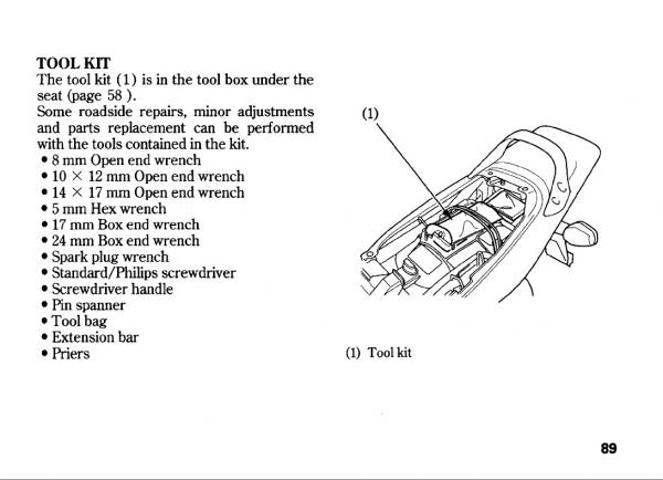

I would suggest that you don't buy from Boom Siew as they will charge you an arm and a leg for the set! See the list as per the manual. You can all these from Mustaffa except for the "Pin spanner" which is a "C spanner" used to adjust the rear shocks preload. Go back to your bike shop and pester them to give you one. You can also try to buy the C Spanner from FJT at Rowell Road or Ah Boy.
The Revo comes with a big box under the seat and will fit all your tools. Just get a bag (from bicycle shops) to put the in. I got some bags at $2 from Mustaffa. As I go touring quite often, my tools set is more than the standard tools listed. Some of it go under the seat and some go in my top-box.
