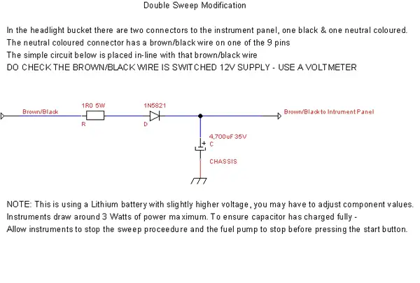

Anyone have problems with a double sweep of the instrument dials?
I cured mine with this modification
Table of testing showing a standard silicon diode v's a Schottky diode

The Schottky allows a little more headroom voltage before brown out occurs. Instruments seem to reset at a voltage of around 8 to 9 volts, this is why a slightly weak battery causes a double sweep.
There is not enough room to place circuit inside the instruments, so I had to tuck it into the headlight bucket. Wrap in insulating tape.
Comments welcome

Ayone have problems with a double sweep of the instrument dials?
[ATTACH=CONFIG]309556[/ATTACH]
Comments welcome
Brother, can we just omit the resistor and diode, but just connect the capacitor in parallel to chassis. In case of the capacitor turning bad and shorting in the future, maybe can place a 1A fuse just before the capacitor as an additional safety.
