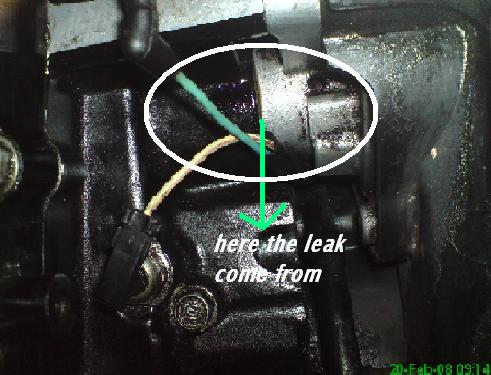

Ah...great!...progress at last. Can't really tell from exactly where beside your marking and having your image 'brighten' up for clarity..only your engine oil sensor is visual. Look like its could be a puncture small crack or hole on the base of your eo housing mannn!...and that's bad. Just wonder how it can be mend..may be use epoxy steel to plug it up but you have to have that area totally oil free for it to mature effectively.:faint:

can anyone tell me this is wad...
1st photo is the casing where behind it had one short rod attach to smth? which i don know...

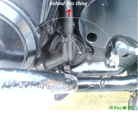

2nd pic is this rod and u will see the leak of the eo
The area item you circled in the first pix is part of the water cooling flow path assembly and that's where one of the bolt(lowest one I think) is for draining out coolant. Inside the round housing is an impeller use to propel (sp?) the coolant for cycle flow in your liquid cooling system.
Your second image is hard to see what you indicate but since you mentioned motor oil, I can guess only it could be an oil seal (if there is any joint part)..otherwise, it can be a from a fine crack to a very small hole which leak under heat pressure from the inner crank case.

Ah Pek, its the starter motor area leh...
Sorry ah thomas...
but i beg to differ... It seems to be behind the coolant pump area. Clearer pics seems to be worn gasket.
anyone else?
  Ah_Ben said:
Sorry ah thomas...
anyone else?
bro thanks for da help
da problem come with da worn out O-ring... jus change new one for my friend shop... da person take out da coolant pump and change da rubber onli...
:cheeky:

Let me slove this problem...
1st thing) Your water pump got problem must fix the oil shield if outside spoilt
2nd thing) if its the inner water colent shield spoilt, must change whole water pump.
3rd thing) its not coolent leakage its your engine oil ...
4th thing) its ok if u don fix but take care of your engine oil.. if too low piston jam..
