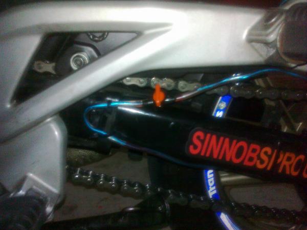

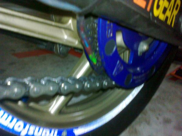

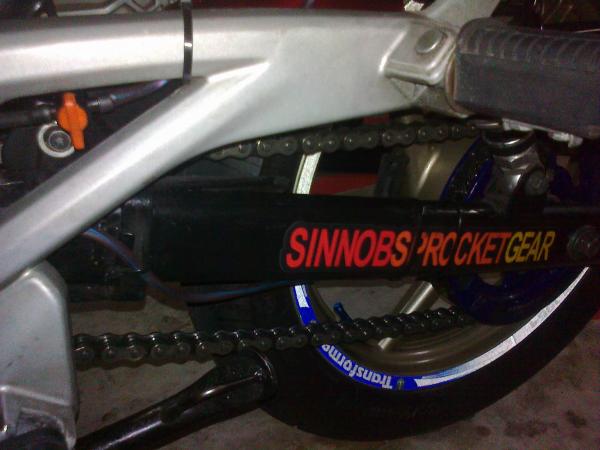

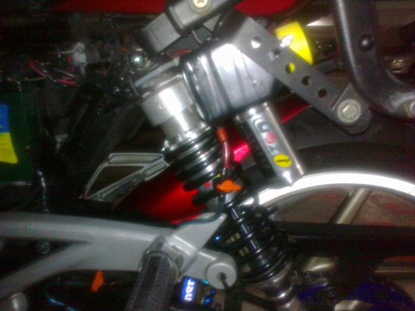

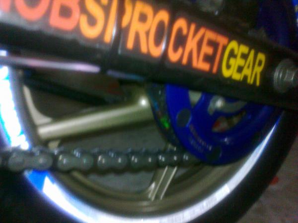

just to share ..... :cheers:
:shy: Did my own DIY chain oiler cost less than $8 (not inclusive Scotoiler chain oil) ... not 100% perfect but it does the job hehehe .... will DO IT better once I found quality accessories ... e.g. syphon, 4mm drip valve , and 4mm good tubing and etc ... but in the mean time will stick to my $8 DIY oiler heheheh :)
Items used:
1: Unused Medicine Plastic Bottle x 1 pc
2: Aquarium Tank Air hose x 1m
3: Plastic Air Valve x 2 pcs
4: Plastic Hose Connector x 2 pcs
5: Flexible Wire x 1m
6: Cable Ties
7: Hot Glue or Silicone
Total cost = less than $8 :thumb:
Items used:
6: Cable Ties
:cheers::cheers:
this to lubricate your chain?? just like we spray the chain once per week or when neccessary?
yes ..
the chain will be kept lube always ... there's always a pros and cons on which to opt for .. wax or oil.
Some said by using wax will not messy your rim .. true? .. hmm not so also. On other cons .. the dirt and sand tends to stick more on the chain and sprocket.
Some said that using oiler will messy your rim .. true? ... yes but has the pros on the other hands ... much dirt and sand will flung away from the chain and sprocket easily too .
So on other words ... both choices whether wax or oiler, you still need to clean and maintain the chain and sprockets to have the life span more longer.
Oh by the way .. to maintain your chain and sprocs life span longer, wise to oil or wax every 300km and wash thoroughly clean 3 weeks once most .... if your body need to scrub to clean fresh, your bike also needs that attention lah hehehe . ... my share only lah. :cheers:
