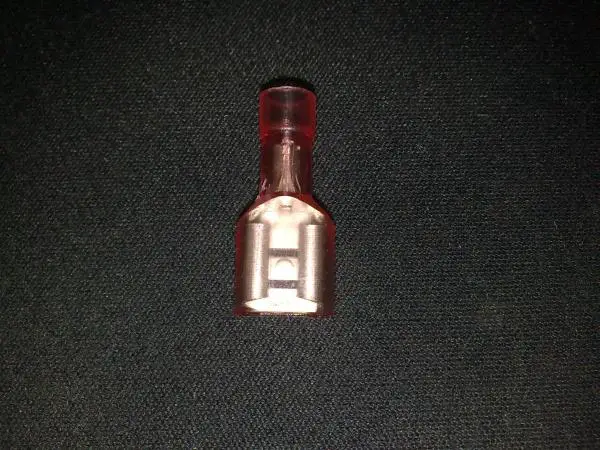

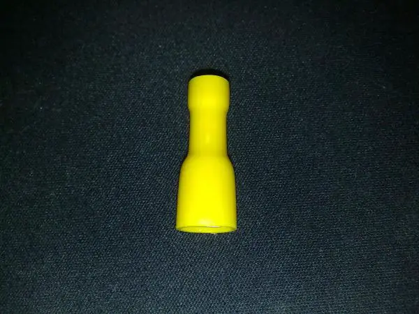

Hazard Lights DIY Session
Date: TBC
Time: TBC
Place:TBC(Likely the same carpark at Ah Boy there cause near the hardware stores)
anymore people interested?
anyway below is the things that need to get for each
arthur, UG2 need to follow your set up for the hazard lights right?
Hazard Light
1)fircyber
2)Brandon
3)harumonia
4)husher
5)NoFishes
6)arthur

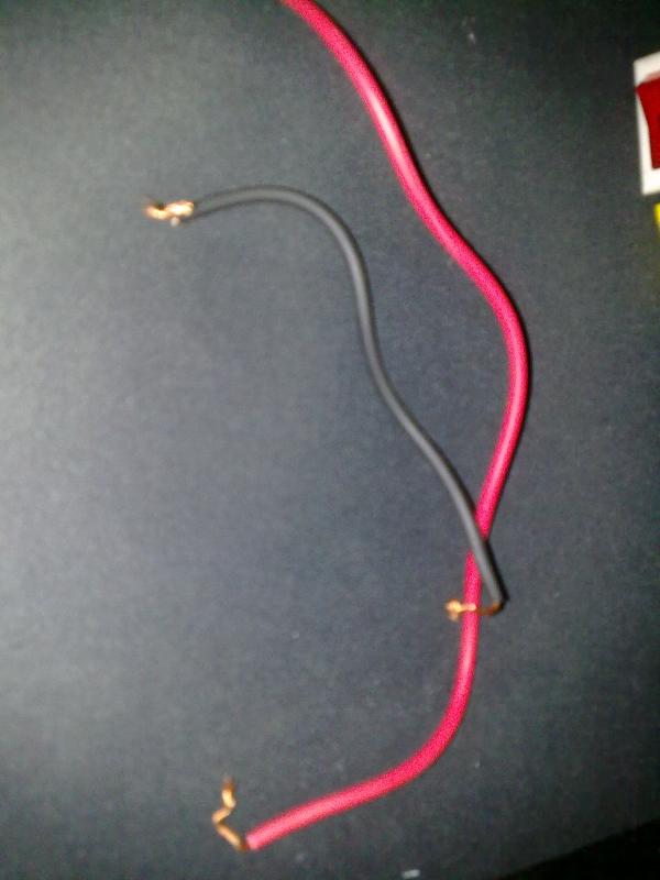

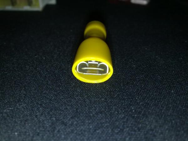

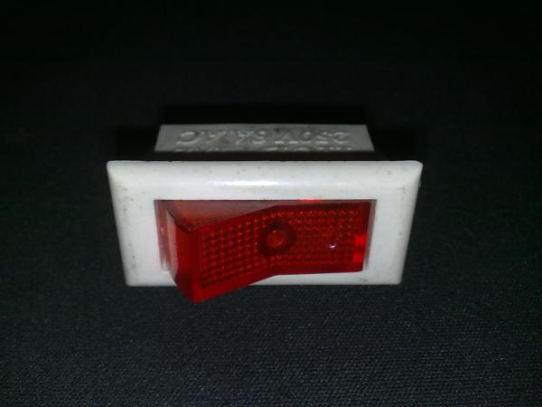

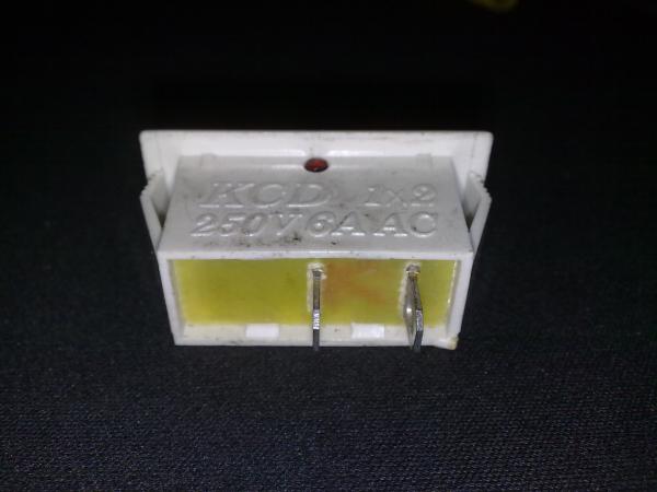

Things needed:
1) small switch with 4 pins(pic show 2 pins one,get the 4 pins one, get from sim lim tower)
2) electrical wire (best is those silver wire inside the insulation, if don't have normal red & black wires will do)
3) cable tie
4) ziplock bag(optional, to waterproof your signal relay under your seat)
5) signal relay x 1 (get from ah boy, UG2 not sure need or not
6) connectors for switch x 6 (6 is just nice, you can get more if you want)
7) black tape
8) wire cutter/splicer
9) heat strink (optional, to better water proof your connectors at your switch side or you can also use silicon to seal)
10) sissors

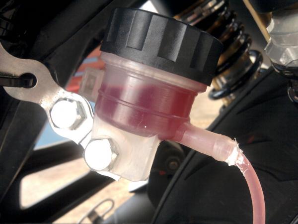

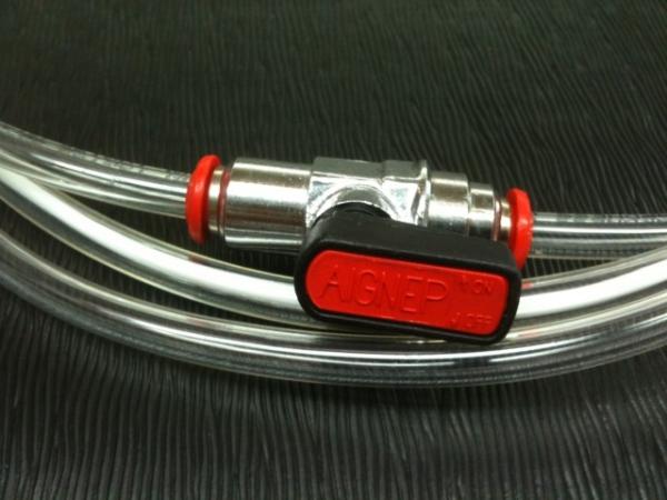

Points to consider:
1) need to determine your exact location for your oiler container
2) what type of container do you want to use? (best is those already with an outlet like brake fluid reservoir or medical syringe,if syringe then need a cover for the top to prevent dust from going in and the fluid from spilling out,bottle cap should do the trick, if no outlet need to drill hole then need extra valve/connector)
3) your chain guard is open or close? (closed chain gaurd need to plan more precise how you going to route your tubing cause need to determine how long tubing need to get)
Things needed:
1) tubing (recommend to get the 4mm one from the valve shop near ah boy, flow rate just nice, 1m should be enough, you can get more to play safe)
2) control valve (get the metal one from the valve shop behind ah boy,$12.50)
3) container (recommend to use brake fluid reservoir,can get from ah boy small one or get a used old one
4) cable tie (need long and the super small ones
5) plier
6) sissors
7) silicon sealant
8) flexible metal bracket (optional, depend on where you want to mount your container, you have to decide before hand, some places can just use cable tie)
9) bolts/screws & nut (optional, only if you use the metal bracket then you need this)
10) metal handicraft wire/electrical black & red wire (if using the 4mm tubing the wire dia 1.5mm just nice, can get from diaso those handicraft wire)
the pics below show the flexible metal bracket i am talking about and the valve
and tubing can get at Teck Siong Huat Hardware
opp the shop selling bolts and nuts under the hdb flats,behind the coffeeshop opp ah boy
Date: TBC
Time: TBC
Hazard Light
1)fircyber
2)Brandon
3)harumonia
4)husher
5)NoFishes
6)arthur
Things needed:
3) cable tie
7) black tape
10) sissors
[ATTACH=CONFIG]180107[/ATTACH][ATTACH=CONFIG]180108[/ATTACH][ATTACH=CONFIG]180109[/ATTACH][ATTACH=CONFIG]180110[/ATTACH][ATTACH=CONFIG]180111[/ATTACH][ATTACH=CONFIG]180112[/ATTACH]
