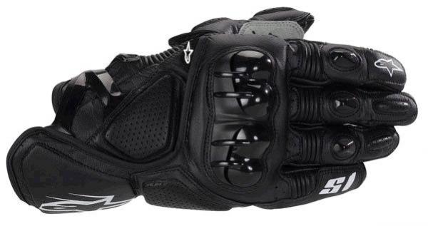

Anyone using Alphinestars S1 gloves?
Can share some review / price on it?
wa. wan buy so nice gloves liao ah?
Looking around for a more durable and offer better protection glove.
Must be affordable too, around S$60.
You got recommendations?
HVC got his RS Taichi gloves @ $50+ @ Moto world !! Mine $60+ used 1.5 years out of curiosity when first time bought it till now not a single tear, still good and durable.
Imho .. if you have to spend around $100 and to have RS Taichi models are still worth the money as the quality and workmanship are really superb ... Quality items does make a difference ... hehehehehe
Same with me on tight budget but yet have to get a protective gears for my wife heheheh soon .. unfair lah if I got mine but for her just normal jacket hehehee ... so if anything happens in case of simple drop or worst , I do not want her to get scratch !!! Think from the box yeah ... pillion safety first priority cos they are the last to react if ???????? !!!!
