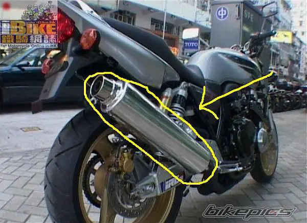

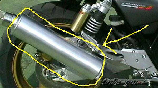

Hey Guys, couldn't find in the forum for this problem, but anyone know which shop can do it? Or whether it could be done myself ? :slapforehead: :slapforehead: :slapforehead:
The first pic is grey. ----->>>> How to make to shiny chrome in the 2nd pic ???? :slapforehead:

super4 original greyish can polish to mirror chrome finish..
items need:
- autosol
- newspaper
- silver cloth
crush the newspaper, dip the autosol around ur pipe and polish in circular motion.. slowly slowly u see the grey fade away... remove ur pipe for a easier job.. u need alot of time and effort... keep polishing until it's really silverish color no longer the grey.. then use the silver cloth and some solution to clean silver dip abit on the cloth and polish again.. super shiny..

Totally Agreed 100%...that's how i do it for my Spec 3..sure shine like mirror.
but after applying Autosol let it be for abt 10 mins or so then use crushed newspaper give it a good scrub..after shine top it off with cloth(no need silver cloth, juz any clean cloth will do) to wipe it again just to give it extra shiny.. :thumb:
