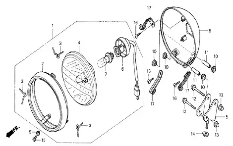

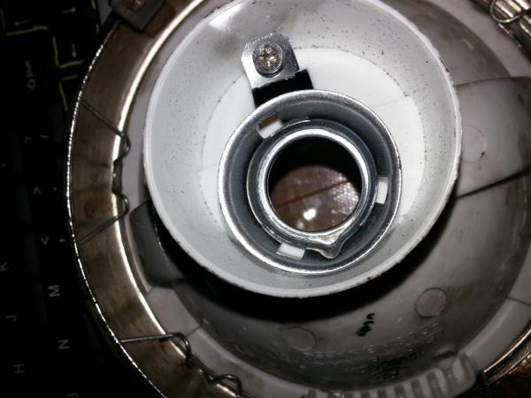

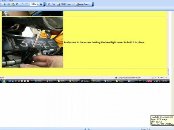

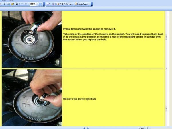

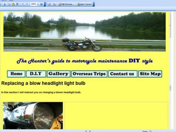

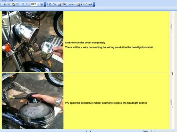

Hey guys, anyone knows how to get into the phantom headlight to change bulb? I open the headlight but found inside the plastic held down by metal "clips" at the edges of the round assembly.. Its actually cos the metal reflector thingy that is supposed to cover the bulb infront has broken off and is rolling about inside!
dont have a proper image but only some parts diagram and an image of my old housing to illustrate:
1. there's a rubber covering the bulb at the center so u will need to uncap it by removing the rubber cover first.. gently
2. u will see the wiring through the rubber cap, leading to a circular flat metal piece, with 3 metal lugs sticking out in the same plane.
3. this metal plate with lugs locks down the bulb inside into the housing. press down inwards real hard and rotate clock wise to release the securing metal plate. if your angle of pressure is correct this will be easy or take a bit of time.
4. the lamp housing will become free from the connecting wire/metal piece. u should be able to just lift up the bulb from housing.
meanwhile if you are talking about the reflector.. once its broke its gone for good.. u can shake it out once u disconnected the lamp housing by rolling it about and fishing for it through the hole..

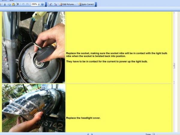

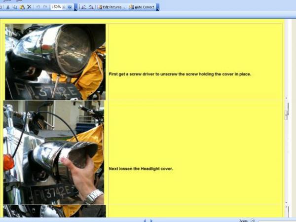

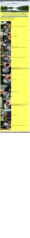

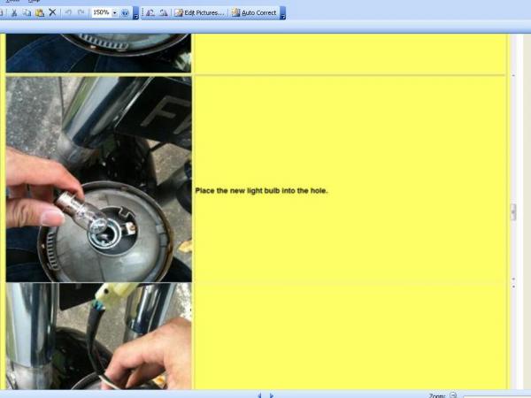

Yes. Got picture? It's been a long time since I open my headlight to change bulb.
I got a photo of a series of screen shots from my old project, hope you guys can see it.
