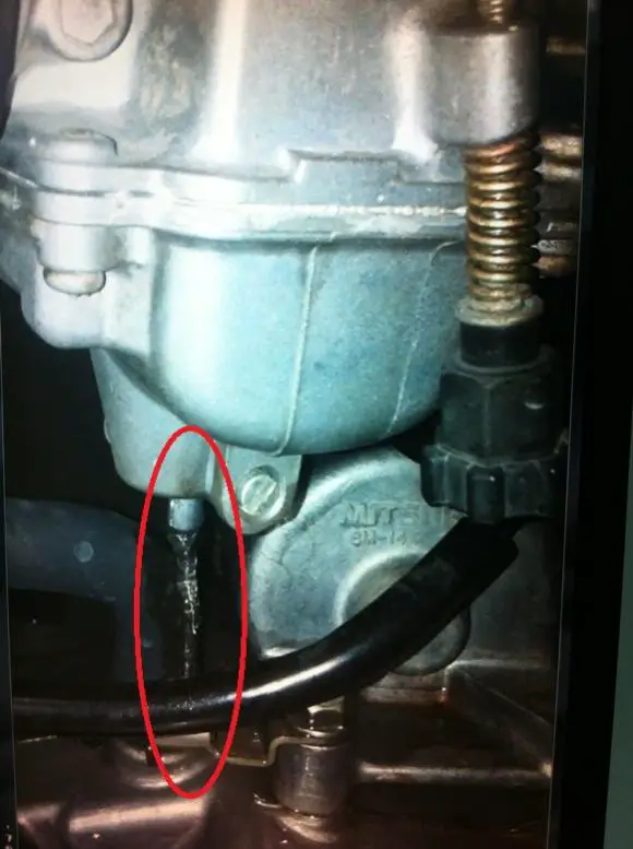

hi all,
i just noticed my phantom is leaking fuel really bad this morning.
anything i can do to stop it ?
thinking of calling a tow to get it to workshop asap.
but since the leak is so bad wondering whether i can stop the flow for now.
any ideas ?

Shut off the pet cock when u off engine. Pet cock is on the left side of the tank, has a knob that shows On-OFF-RESERVE (or just ON-OFF for some models). Immediately rectify the leaking problem. Leaking petrol can cause your bike to burst into flames anytime.
i think also have to identify the location of the leak.. skali it begins before the petcock...
thanks for the reply guys, yeah I can stop the leak by turning off the petcock. I took a picture of the leak posted below for those who would want to know the exact issue.
Have it checked at the workshop. they say there's a part called *something* jet got problem which suppose to control the overflow of fuel.
Got it fixed last month with a 2nd hand part, but in a month now leak again (although not as bad as last time). Going to go back to the shop again -_-
[ATTACH=CONFIG]286139[/ATTACH]
is the part circled a tube connected to the bottom of the carb? that one is the carb bowl/carb overflow drain tube..

you have what is known as carb overflow problem..
the shut of valve at the bowl cannot shut off the petrol when bowl is full..
at this condition your bike will stall when u try to increaee rpm by throttling..bike cannot be ridden as it will stall frequently.
sometimes it is caused by dirt etc stuck at the valve...preventing it from shutting off completely...in your case worn out needle/jet
