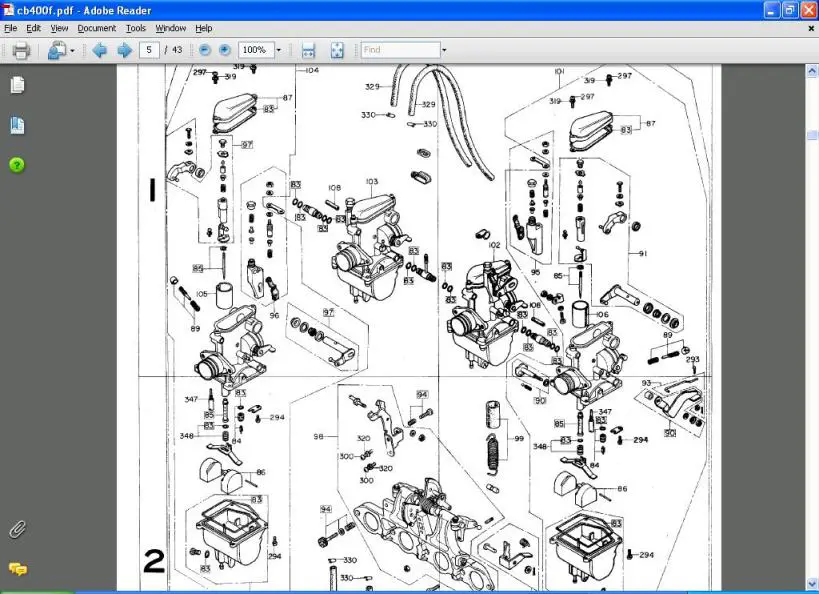

After that he opened my carb, blew every hole with the air hose and spotted something, a line inside my carb. (2 lines at the yellow part of the carb, something like a yellow flap, i dunno wad's the name of the part).
So he said there's a small hole but it's not visible to me. I dunno whether he's trying to be professional and find a mistake to answer the problem or wad. So he says if i really want to 'cure' the problem, i'll have to change my entire carb that costs $2k+!!
Do you have any picture of it?
A picture speaks a thousand words...
