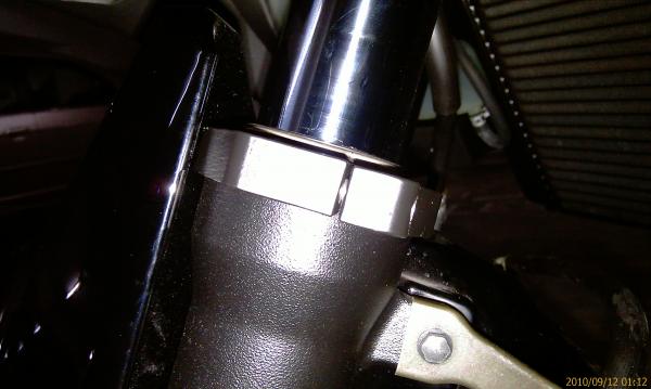

i've tried to fix up the fork brace but it seems that the 2 most outer screws can't be tighten all the way.
anyone facing the same problem as mi?
seems just abt right
Correct...Should not be tighten...just like ur triple head clamp...
Got it, thanks alot.
