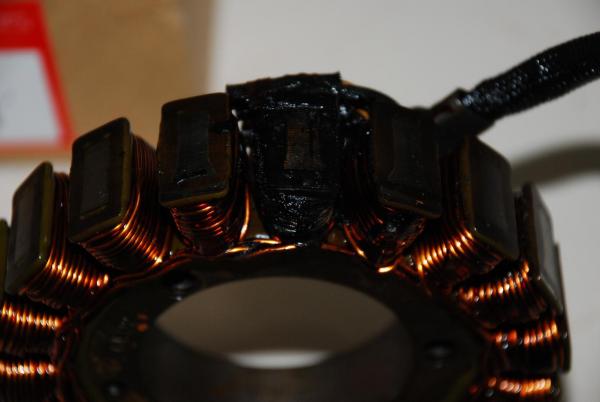

****, burnt my coil again due to overloading..FYI guys, pls dont overload ur bike with too many lights. Mine jus burnt as i install 2 more HID. Drew too much current, my coil burnt ! Expensive lesson learnt.. :(

who told u its because of overloading of too many lights?

i asked a fren who specialize in alternators. Cos b4 i install 2 more HID bike was ok. But after install less then 2 weeks, the coil burnt liao.
Told me is becos the initial ignite of the HID is drawing 10A each. So if i on all 3, its 30A being drawn. And our bike cant support so much..

HID will cause the coil to burn?
I've been using for a year, never burn yet.
I have voltage stabliser and 6 pts grounding..
duno whether it helps..
His got multiple HID.
christmas lights.. hehe..

how come fuse never blow before coil??
Not sure oso..was told that the coil kinda like overheat. Seems to always burn at the location where the output wire is. Refer to the the pictures..

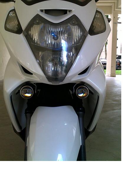

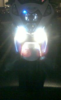

I uploaded a shot of the extra lights too.. :cry:

about the coil burning, ah choong ever told me it is caused by "overheating", result of using #w50 or heavier EO coz they're too heavy to "splash" cool the coil. anyone ever heard this theory elsewhere? :?
i was using the maxima extra 15w50 (its formula is heavier than the normal w50) when coil got burnt (bike still in rather stock condition then), got it replaced by BS under warranty. now faithfully follow the owners manual's recommended #w40 :thumb:
think there could be SWingers currently using the heavier 15w50 but didn't have coil problem... dunno what is what liow :p

The picture of the coil, may I know if it is a stock coil or re-wire coil...?
