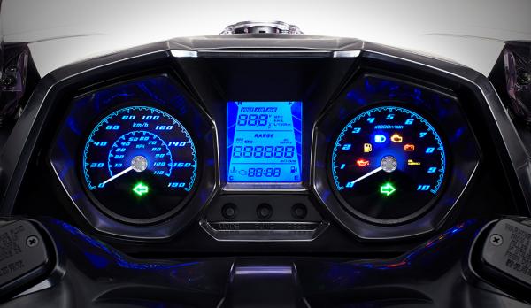

meter speed will be faster than gps speed by up to 10km/h difference.
in actual fact, it is better to use the meter for accurate speed.
accurate speed of the meter i mean.
eg. meter 100km/h, gps will be around 90km/h -95km/h.
