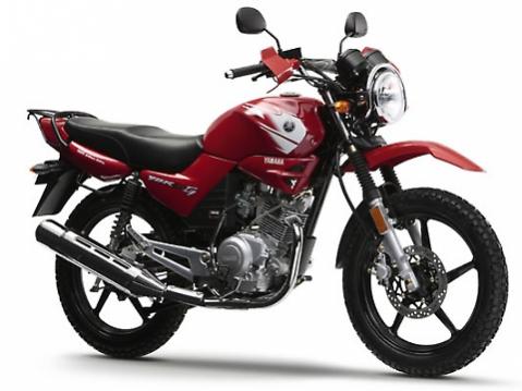

I used chiong super4 headlight and universal headlight mounts. Got it done at Hua Chin (bukit batok). total cost 180+. together with front signals. also super 4 ones. Yea its expensive but it changes the way the bike looks. IMO the alien head that comes with the stock YBR destroys the look of the bike. Its fugly. Marketed in china. brazil and europe got the round headlight models.
[ATTACH=CONFIG]259227[/ATTACH]
Nicely done, one of the best looking YBRs I have seen in SG :thumb:

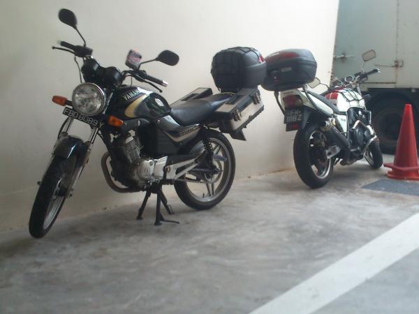

my two babes..
http://i11.photobucket.com/albums/a169/malex_sky/signature.jpg
hot babes...
