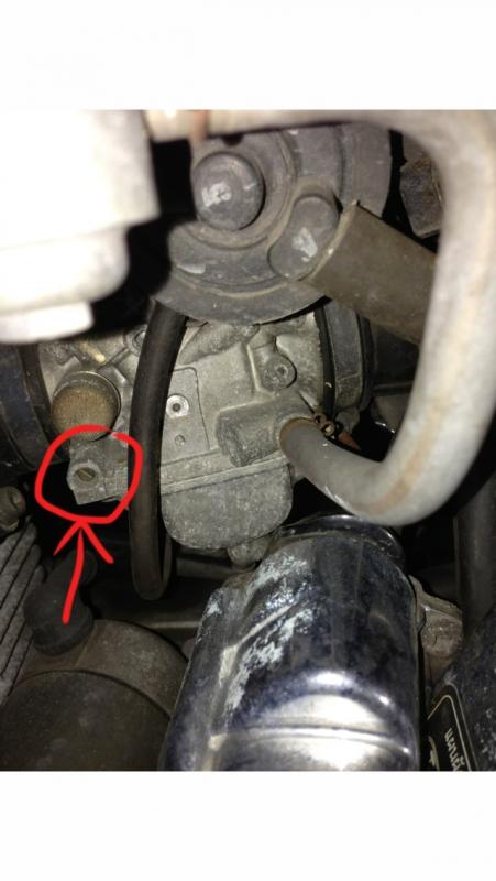

Hi bros, can anyone advise is this fuel-air mixture screw? [ATTACH=CONFIG]264593[/ATTACH]
that is the idle adjustment screw. it will only affect ur idling. to adjust ur actual A/F mixture wen u are riding, u nd to dismantle the carb and change jets or adjust the needle.

Just to reconfirm about the mixture screw, I was referring to the screw that I circled and which can only be adjusted with screwdriver, and not the big one that can be turned with fingers.. is that small screw also the idling screw? Does that mean there are two screws to adjust idling?
Thanks bro Naim for the correction. :)
the one u circle must use screwdriver. dat one affects the air/fuel ratio at idling. the big one changes the idling speed. if no problems wif ur idling and starting, no need to adjust lar.

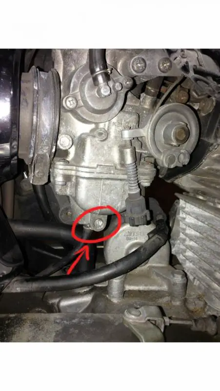

Oic... Thanks bro for always helping out here :) By the way do you have any idea what is the screw on the 2nd attachment with the VE marking beside it?

idling can be adjusted by a big plastic knob..on the right side of carb...this act as a stopper to the throttle minimum position.adjust knob is just moving stopper higher or lower...try it then u will know.
the other fuel mixture screw..look arounf sure u can find it..how to adjust it??
if you have a rpm metr or tacho..it is easy..on a phantom this is what i will do..
make sure bike is warm up as after a ride..do not adjust when bike is cold.
turn idling knob to increase rpm..say 2k..or by ear hear rpm goes up ...xxx
now look at fuel mix screw position..dont forget the original position,if u screw up u can reset to what it it was.
at a higher idling the bike will be reving away...turn fuel mix screw clockwise or anti clock wise..try one direction first..
what we are looking for is an increase in rpm...if it increase rpm slowly turn until you reach the maximum...
then back off 1/2 to 1 turn..up to you...
note you should be counting how many many turns to achieve max rpm..
at the max rpm setting ...it is bloody lean thats the reason to back off 1/2 to 1 turn...ie adjust how lean or rich with this screw
if u mess up go back to oringnal setting ...thats the reason you are counting the turns u make..
after the fuel mix is adjusted as to your requirements...
lower the idling rpm...
test ....rev up and down...see whether the bike is reponding to your requirements..if not adjust fuel mix screw again..and again until you are satisfied..
test ride...you want back fire..evo wrc rumbling..etc etc..u can do it with the fuel mix screw..or just great perfomances it is up to you.

I've looked around the carburetor and only found 2 screws which look like they are possibly mixture screws. Can I trouble you a little bit more to look at the previous 2 attachments a few posts up to help identify which one is it? Is it the one at the right side of bike at bottom of carburetor (without any markings) or the one on the left side of the bike (with a marking that says "VE")?
