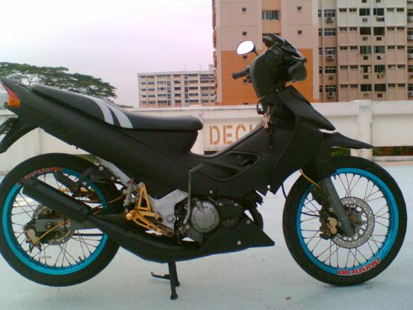

Hi guys, I recently just got my ta200 sprayed Matt black. However
I did a really stupid thing.
There were some white stains on the fuel tank and I tried to use a wet clear
cloth to wipe it off but it just won't go away.
so I stupidly go and use a metal wax polisher and applied some of it on the affected area hoping that it will go away. It made the situation worse! Now instead of just a small area, it became patches of greyish colour. It seems that the wax has "eaten" up the Matt black finish. The greyish area
are now smooth instead of the rougher surface on the Matt finish
Any expert please advice me what to do??

i dun think anything can be done already.. either live with it or respray it..
or try to polish the whole tank to look the same as this smooth greyish colour? maybe with the whole tank looking that way may actually be nice?
http://simonnunis.smugmug.com/photos/684724736_fuDoa-M-1.jpg
no harm trying this.. might turn out nice!
sigh i think i have to resign to my fate then
If i choose to re-spray it? which brand should I buy?
RJ London is quite good..
hey...do take a picture of how it looks like ok? never seen how the fuel stained paint looks like.
Maybe you can sketch some nice design based on 2 different color tones, matt black and grey, and start polishing the design out?

Actually, there is a way that might just work!
Wet Sanding the bright shiny patch.
Use 1000 grid sand paper that you can buy from hardware shop and wet sand it. thats how the car work shop do it to roughen surface for clear coat.
nothing to loose right? all the best!

yea that is correct. using 1000 grid sand paper to wet sand will only remove microns of paint. if not confident then use 2000 grid also can. even more fine.
i know the idea seem funny. but because oil compound from his wax during his rescue efforts have sipped into the matt paint job thus making it shine. To rid that, this method works just wipe dry aftr that and end of story.
If it was to remove blurry fine scratches from clear coated paint jobs, smooth peanut butter also can.
but in this case it is a matt finish so..wet sanding.
