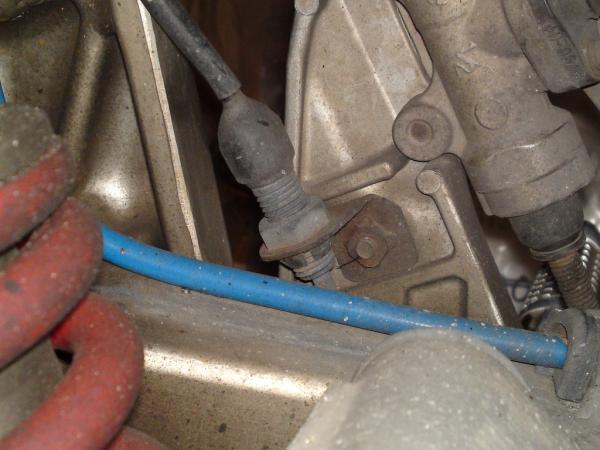

ok, i just checked my brake lights. both front & rear brake light not working. but i've managed to solved it. for the front brake, there's actually 2 wires connect from the lights to the lever. 1 was just hanging there. after pulled out & plug in, front brake triggered the lights.
for the rear brake, @ the inner part of the pedal, there's 2 tubes. 1 is the brake fluid, the other is the wire to back lights. its fixed nicely there but actually right @ the bottom, there's a thin wire like hook. it must be hook to the pedal, so when you step down, it pulls the wire, brake lights on. you wont be able to see it, gota put your fingers in & touch. screw the whole assembly down abit, hook it back, then screw up till just nice, otherwise your brake lights wont go off.
attached pic is the assembly @ the brake pedal. screw down to loosen, hook the thing back onto the hook, then screw up back.

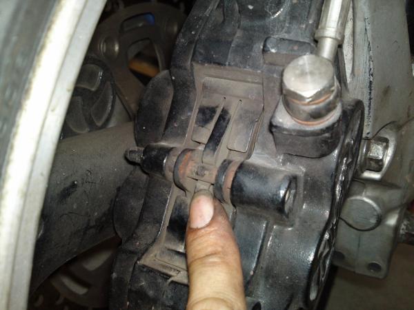

today i checked my brakes & noticed something is loose or does it actually has free play, i dont know. so i'm checking you with guys. the area my finger is pointing, there's abit freeplay, can move left right cos both sides also move. i think its the brake pad, not very sure. thanks. tml will try tighten the screws & see how.
pls dont give me rubbish answer. if ask me go shop, pls dont post....:lol:

i dunno wor. for big things i always leave bike there 1

haha Ben sorry sorry, during that time i was out field. so kinda forgot to reply. had quite abit of prob during that period. i think the cabling was just abit loose or sth. now seems to be ok already. the rear brake lights also can work already also. the switch to trigger the light was broken just needed to change it. 15 bucks.

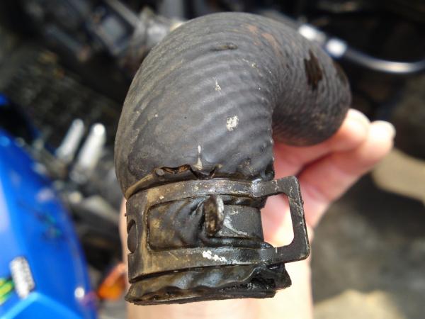

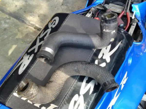

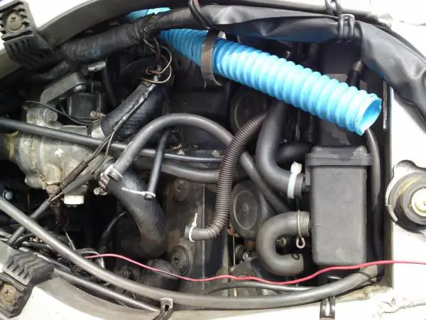

just went there to have my coolant hose changed as it was leaking, no wonder temp never goes down.
temp now dancing like disco. once throttle open, temp shoot down.:thumb:
so for those if always temp high over 1/2, never go down even @ 100kph, better have it check, it might be leaking @ the clips. changed both @ engine, coolant flushed. $110

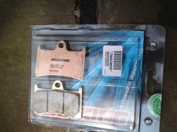

also changed BRAKING pads, poisoned by bro squid... $140.:cry:
by the way, its recommend by bro squid, the ah tak.:thumb:
