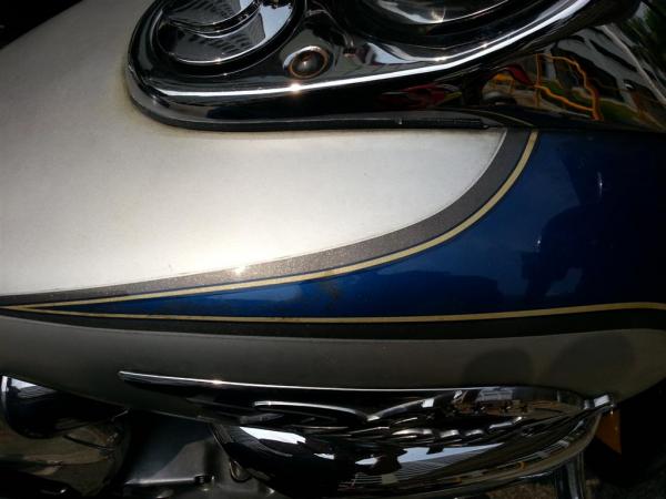

hi folks, i got my phantom recently and i realised my tank doesnt have the shiny finish like other phantoms do. the surface finish is kinda matt instead and despite using turtle wax it doesnt really get any shinier. am i missing out on a step or something?
operate a vehicle in a way that you benefit other road users pls - and meanwhile, stop whining! be responsible and be safe.
Take a photo? Is your bike matte in texture to begin with?

i cant be too sure leh. when i toke over it a month ago it was quite dirty but it definitely wasn't glossy shiny. other than that just the stickers pasted over.
i'll upload the photos tomorrow once i get access to my bike!

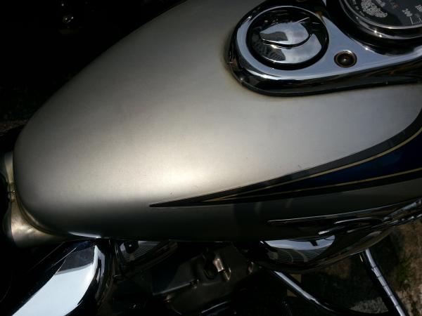

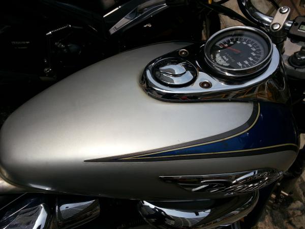

Β
here are the images of the surface of the tank!

Seems like ur lacquer probably nt smooth alr. Wat uncan try do is get rubbing compound and rub down d whole tank. Followed by polishing compound. Shud give it a better gloss finish.
Β
One expensive product dat works is meguairs ultimate compound. Its like all-in-one (rubbing+polishing compund). Works great to refresh those dull paintworks.

i always read of meguairs product in sbf but dun really see it around much in stores.. where do i get it? also will rubbing compound remove the paint? its nots like autosol right?

I have seen them in Giant as well as home-fix stores. Its a slight abrasive but very fine n specially for paintwork. Does d same job as autosol. It will actually remove small amounts of ur lacquer so use wif caution. Just in case ur lacquer is very thin.

looks like i'll have to make a run to giant one of these days to take a look! my concern is i dont even see any lacquer gloss in the first place even before i applied the turtle wax. tempted to just leave the bike at some shopping center car park where they hv car polish services like those at imm!

Shud have la. d lacquer quite thick. Usually those dull paintwork is just because previous owner nv polish frequently. Just nd to buff out wif compound. To go to those car detailers i even more worried. Cux they might straightaway use those electric polishers which cud be too quick and easily eat into ur lacquer (esp ur bike old alr). At least u do by hand, u can slowly do and frequently wipe off n check.

i got it from ntuc at jp and its really expensive! it doesnt seem to be working to me or i maybe i didnt try hard enough! after all that rubbing what i get is still matt surface.. how do one even tell if the lacquer was there in the first place?

gd question sia. i oso duno hw to tell. hmmm if using the compound cannot get it to shine, i nt sure eh. cux from my experience, even if no lacquer, u buff wif d compound oso can get some shine one. definitely better than matte.

woah. i think ill spend sometime over the weekend to buff liao. if no lacquer means i have to find something to seal in the shine alrd? can turtle wax do the trick?

nah. dun tink wax on base paint will be much help. u really need a good clearcoat to protect the tank. worse come to worse, can DIY lor. just spray on clear lacquer.

do you have any clear coat lacquer to recommend and where i can get it?

i personally had good experience wif Nippon Pylox one. cheap and can get at almost all hardware store. some others oso use RJ. doesnt beat having a proper clearcoat.
