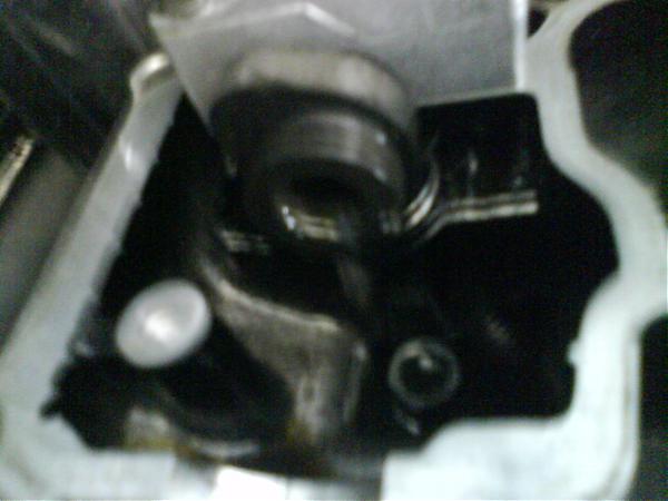

Valve clearance job is adjusting the clearance between the cam and the follower. If the gap is too big,bike got no power due to the valve not opening big enough for optimum peformance and if its too tight,the valve will not close properly,thus you have compression leak and overtime burned valve due to the valve not able to transfer the heat from the face to valve seat. Here's a picture showing my bike's no.1,exhaust camshaft.
