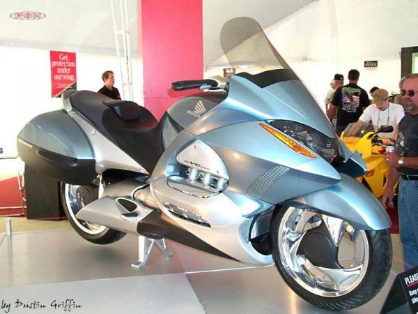

Will the next one be here sooner ??
We have seen the attached one in artist representation before. I have here one that is the actual model
We have also heard predictions that it may model after the new 2010 VFR1200 ???
My guess is as good as yours... and hopefully we will see it much sooner :dot:
