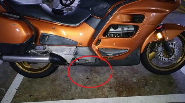

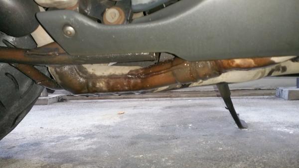

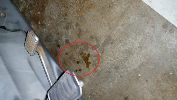

Hi Seniors, have anyone experienced the minor oil leaking as shown in the photos?
