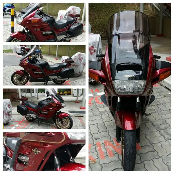

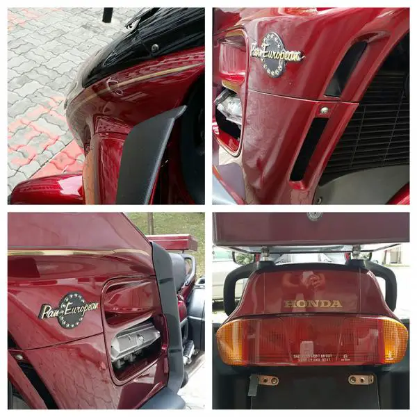

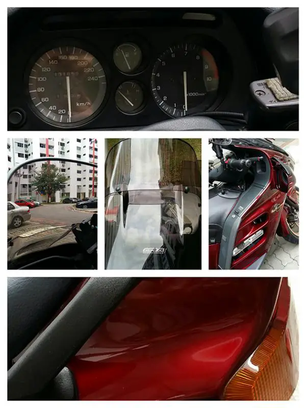

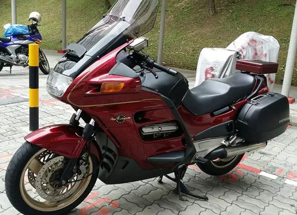

For sale Maroon colour ST11. Great condition for those who wish to keep this Sports tourer for long term.
1) FV plate - last batch of ST1100.
2) SK metal bracket for top box
3) Metal base from GIVI
4) Original windshield still in good condition
5) MRA windshield - See pics for condition
6) Motul 300V engine oil
7) Service every 5000km
8) Owner's 2nd bike
9) Minimal touring
10) Mileage - See pic
11) COE end 2022 Jul
12) Stock condition / Engine in great condition
13) Stock parts to be given as well
14) Looking to sell. Highest offer secure!20150226_161622_resized_Fotor_Collage.jpg20150226_161929_resized_Fotor_Collage.jpg20150226_162615_resized_Fotor_Collage.jpg20150226_162911_resized.jpg
15) Major parts changed
16) Low milage - 131,000km
17) In good condition 8/10
18) SMS or whtsapp +65 92984668
