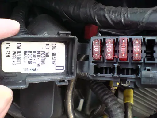

hi, got a problem here, my headlight is not working man, changed bulbs but still not working, changed to my spare headlight still not working.. ... but the signal lights are working..... can anyone tell me whats wrong wit the bike please... haizzzz.... thanks a lot in advance....
blurrrr.....................:thumb::gun:
open ur fuse box, check the the 2nd one (frm left) it's probably blown. replace it
http://i125.photobucket.com/albums/p48/allen_key/KS_400.jpg
It may be the fuse located left side panel of the bike..:thumb:
