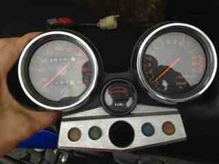

Guys,i noticed that when for eg. i signal left, my right signal light and also my meter lights will flicker together with the same "Rhythm"..
Just wanna know if its wiring issue or battery, coz i juz had my batt changed in the beginning of the year. tq
Which version of S4 are u riding and what model of battery are u using? If it's a Vtec and u are using "BS9" battery..it's likely because the battery won't last more than a year sometimes as the current rating is low.
