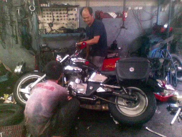

thanks anyway for recommending Planet, went there once, Chong was really nice & i realised that i kanna "carrot" by other workshops all these years. :(
Edited by bukitmerah
planet
