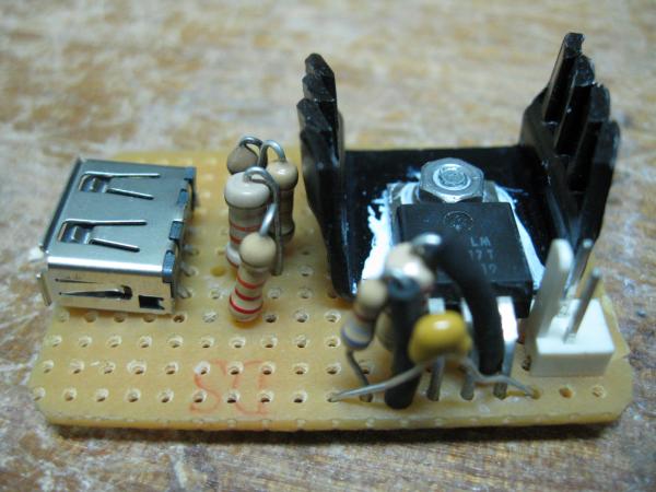

i did this up to charge up my iPhone. working fine. i pack the board into a box and leaves it on my bike behind the headlight. it is not a waterproof box but i silicon-ed up all the openings less the usb port area which i need to plug in. so i taped it up with black tape - army style. ultimately i am not going to use it in the rain so yea. if you need the schematic do let me know. it is very simple and very low cost. less than $5. so who still needs a ciggy power socket?! anyway do take note that the iphone is a very picky phone so it does not accept just any usb powered outlet for charging. you need to provide a voltage reference to the + and - data line (missed out by most chargers not made for iPhone)
will post more photos of final product if anyone is interested.
